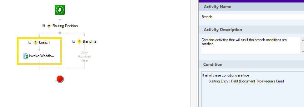

Sure no problem. One way would be to invoke a workflow based on a routing decision inside a workflow like this:-

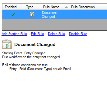

Or you could alter the starting rules to trigger based on metadata like this:-
Hope this helps point you in the right direction! smiley
