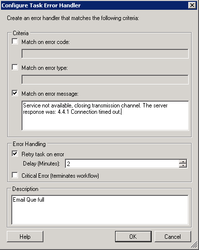

My question however is around the setup of the message in the Task Handler as it does not seem to work as expected. The Workflow is not retrying the activity, and fails after the first encounter of the error.
Seeing as the first connection time out error contains a duration that might vary, would it work to ad the message with wildcards like follows:
"*4.4.1 Connection timed out*" and then same with the second error?
Current Configuration looks like this:
Any suggestions would be appreciated.
replied on April 18, 2018
Partial matches are not supported. Just add separate handlers for each one.

replied on April 19, 2018
Workflow does have a built-in retry mechanism because there is a default task error handler for SMTP exceptions. It is, however, set to match both on exception type (SMTPException) and message ("The operation has timed out."). You can take out the message and it will retry on all SMTP errors. Or we can look at the stack trace for the error message for more information and tailor a new handler more appropriately.
