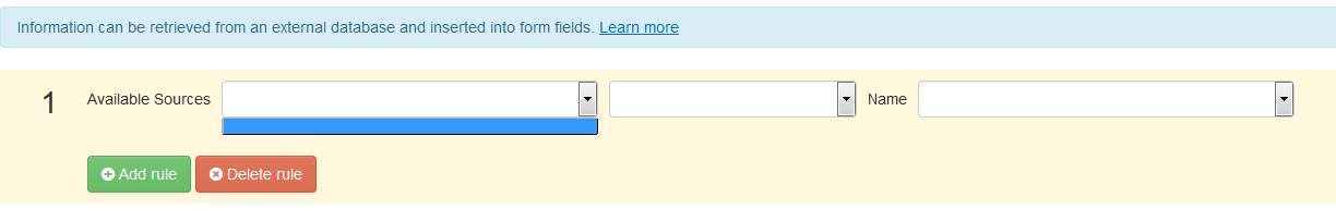

Hi All,
Not being a Forms Guru I am starting to 'play' to familiarise myself with Forms.
I am trying to setup a DB lookup to populate a drop down from an external DB in forms. I've added several data sources and the data connections test successfully.
However when I go to create a lookup rule, no sources are listed. It's just a blank drop down.
What am I missing? Is there something I need to refresh or sync?
I've tried re-booting the server LF forms is hosted on (after re-starting the forms routing service) and it's still blank? angry
Any help much appreciated. yes

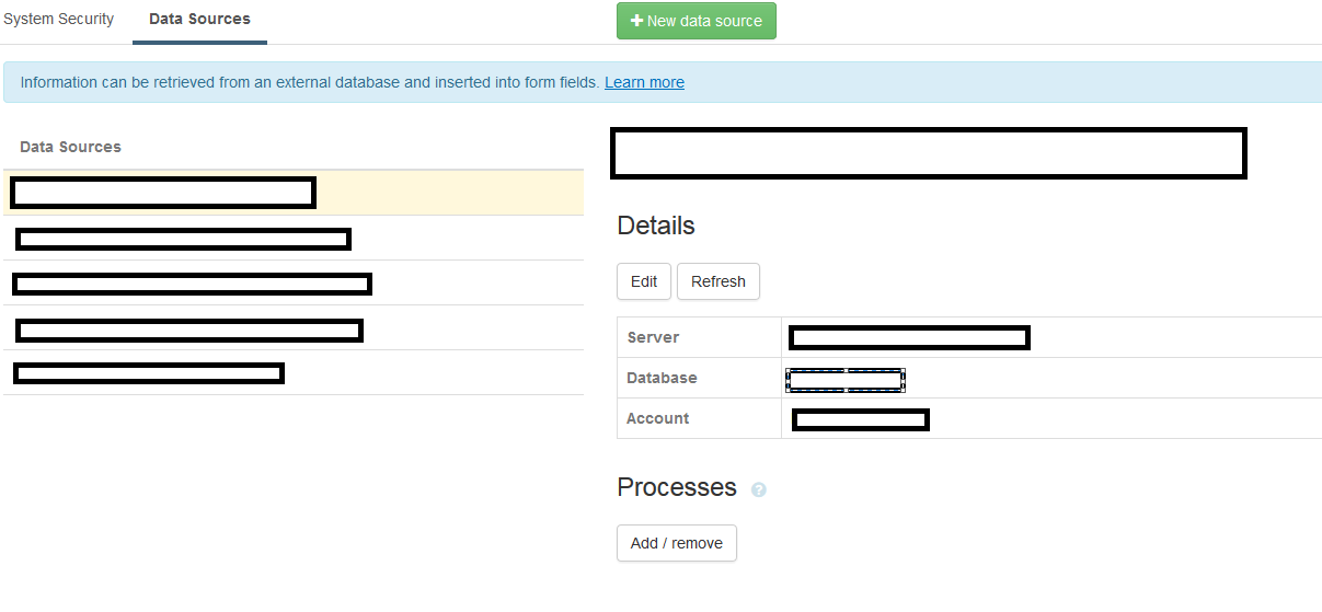

Did you add the process to the data source using that "Add/remove" button right underneath the Details about the server in the first screenshot?
In LF Forms, you need to not just add the data source, but also define which processes will be allowed to use it. This is a separation of security as you need to explicitly give access to each process for each data source they are allowed to use.
replied on July 17, 2015
That's the ticket Kenneth! Simple when you know how! Although that's not very intuitive... frown
Cheers! yes
