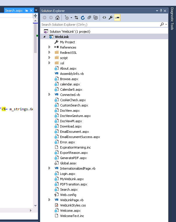

I tried to rebuild it but it creates WebLink.vbproj.user in place and another file of the saved project
is there a parameters I need to modified to get the WebLink.vbproj rebuild
replied on February 23, 2017
they said add one line of code to Search.aspx.vb. At line ~305, but this file is not listed in the WebLink.vbproj. I modified the file directly and buid the solution. but it create WebLink.vbproj.user and the file WebLink.vbproj are not really been modified.
I restarted IIS, but this is still not working
OK got it, in my situation the search was done on the welcome page, so the file I should modified was the welcome.aspx.vb at line 61 (second line in the following code)
 MySearchResultsBrowser.Columns = WebLinkControls.ColumnSelect8.GetSelectedColumns(Page, m_Conn, "SearchColumns", Nothing)
            MySearchResultsBrowser.DefaultSortColumn = Column_Type.COLUMN_TYPE_LASTDATE
            MySearchResultsBrowser.Visible = False ' SCR 124092
And I build back the weblink project, restart IIS and now it works
