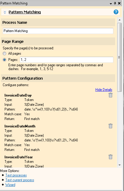

How is your "Back Page" process set up? Is it running on all pages? What are the settings in your pattern matching process?

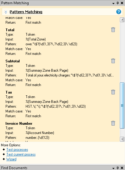

This configuration works for me. Where is the token for the second page (your screenshot only shows tokens off the %(dateZone))?

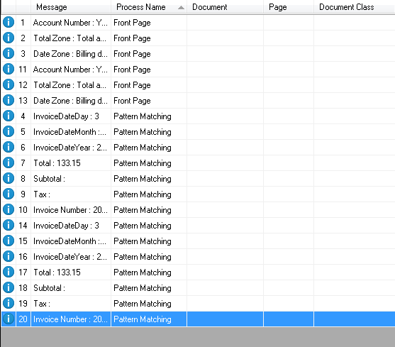

What do you see in the Processing Information Pane (F5 to open it if not already opened) when the 2 pages are processed?

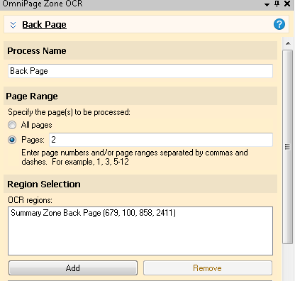

The Back Page OCR runs only on page 2 and I changed the sample page of the OCR to page 2 in order to select the correct zone on the page. The Pattern Matching process runs on page 1 and 2. See attached pics.

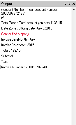

The Tax and Subtotal tokens are taken from the back page OCR. See pic1. I've attached both the Processing Information Pane and the Output log.
replied on July 15, 2015
That must have been from a test process, which I now understand only runs on the current sample page. I ended up having the classification recreated from scratch, and after a few issues with the last page identification, it looks like it's working! The setup is, as far as I can tell, almost identical to the first attempt though. There may have been some confusion as I was testing different setups using the test processes function rather than actually running the test invoices through.
