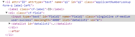

To explain more, if you look at the page elements using developer tools, for a field it would look like this:
There are two ids for a field, one at <li> level is in format of "q1", while the other at <input> level is in format of "Field1". The custom CSS name is also at <li> level. And if you want to do values operation for a field, you will need to perform on the <input> level.

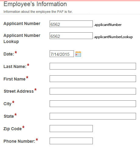

Rui, thank you for taking the time to look at this for me. I tried to follow your instructions, but I apparently am not understanding something correctly as it is not working. Below is a screenshot of part of the form in question when it reaches the user task along with the CSS classes next to the two applicant number fields.
I added the following jQuery to the form:
$('.applicantNumberLookup input').val($('.applicantNumber input').val());
$("#q5").attr("vo", "e");
 $(".applicantNumberLookup").change();
#q5 is the id of the Last Name field. When I pull the form up in the user task in question, a lookup is not performed on the last name field. Am I understanding your code wrong?

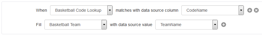

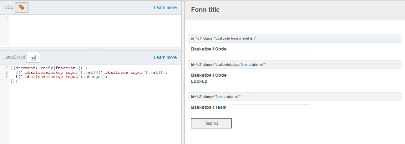

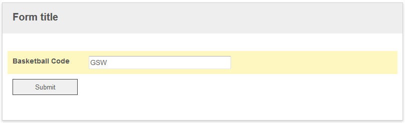

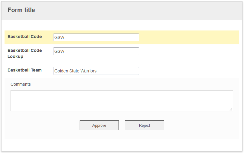

I'm not able to recreate the issue. Here's a test business process I've created. Note that this process uses two different forms: a starting form and a lookup form (for the user task).
Lookup Table
Starting Form
Lookup Form definition/js
Lookup form's lookup rule
Lookup form user task approval
In your process, are you using a single form for everything or are you using two different forms for starting the submission and then for the user task (as I am above). Also, can you confirm that the lookup rule itself is configured to run based on the correct field in the correct form?
