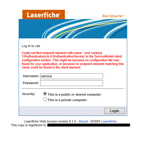

Web Access 8.1 Could not find endpoint element
asked on July 13, 2015
My customer is trying to run Web Access 8.1 on a Windows 2012 server and is getting the above error when they try to log into their repository.  Can anyone give me some things to check to try to resolve this?
