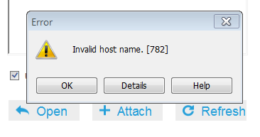

"Invalid host name. [782]" when logging into a repository through the desktop client.
asked on July 9, 2015
A client randomly receives error 782 when logging into a repository through the desktop client.
This issue does not happen all the time and seems to resolve itself. I read that it might be a DNS problem and that there are temporary fixes. Anyone know what exactly might be causing this? Thank

replied on July 15, 2015
We are having the same problem with different users getting intermittent Invalid Host Name errors.  We would like to try using the IP address to attach the repository, but do not know how.
Here are the details on a few recent errors.  The user got the first error while trying to work on a document.  She closed the document and got the second error when she tried to open another document.  She closed Laserfiche and got the third error when she tried to open it again.
