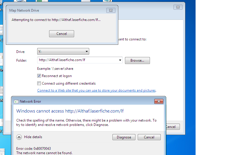

Yes i am trying to set up WebDAV to set Laserfiche as network folder to access the file from repository,as per the guide,i set default repository in server settings and tried to map the network drive.the snapshot given below describes the error
replied on July 10, 2015
Is the Laserfiche Server listening on port 80?
Do you have a default repository configured in the Laserfiche Administration Console's Server Settings?
Just to confirm, your domain is laserfiche.com and the Laserfiche Server hostname is Althaf? What if you try using the IP address of the Laserfiche Server instead of the fqdn?
replied on July 11, 2015
Yes..Laserfiche server listening port is 80 and default repository also configured in server settings.
when i tried with the IP address,still same network error occurs.
IP address you meant the local IPV4  IP address right?
replied on July 13, 2015
Please see item 1 under the Troubleshooting section of this informational site about configuring WebDAV.
