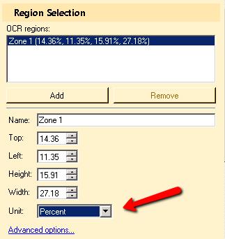

Question #3:
Our scanned images are sometimes vertically elongated and thus several fields are falling out of the 'Zone OCR' scan range. Since every page has a QR code at the top, is it possible to align the scanned images inline with the 'QR Code' and then re-size the image accordingly & then extract data?

For question 3:
When configuring your zone OCR, try changing from pixel to percentage. This will adjust accordingly based on the size of the document. If this is not suitable then I would suggest drawing a larger zone to accommodate for the elongation.
