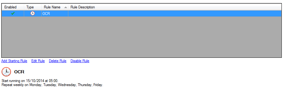

Check that your rule is enabled:-
(there should be a green tick under the enabled column like this)
