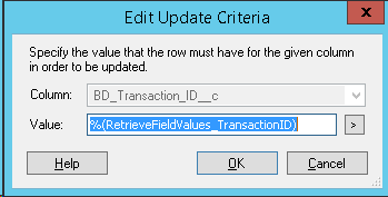

value of filter criterion for field 'BD_Transaction_ID__c' must be of type double and should not be enclosed in quotes
You can see Laserfiche Workflow is putting quotes around that value.
Unlike when using Custom Query and a Query Parameter, that you can tell workflow the type, in this case there is no place to define the type.

For the first parameter, is the Type set to DateTime? And is the second Parameter Value set to the full token %(RetrieveFieldValues_TransactionID)?

The second parameter yes is set to that and the type is set to INT32 (which was our problem before).
