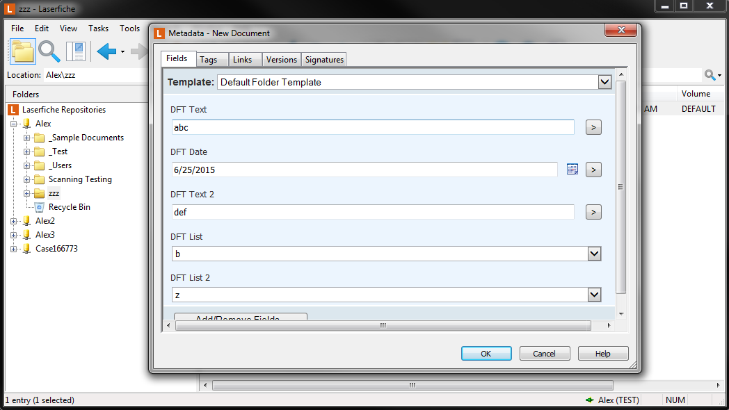

The %(Parent) token works for me with list fields so I'm not sure what may be causing your the issue you're experiencing. Are you using standard list fields or are these dynamic fields? Here are some screenshots of my setup.
If you need further assistance troubleshooting the issue, I would suggest contacting your Laserfiche reseller to open a support case.
