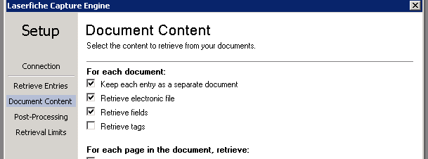

replied on June 24, 2015
In the scan settings make sure that Retrieve Fields is checked.

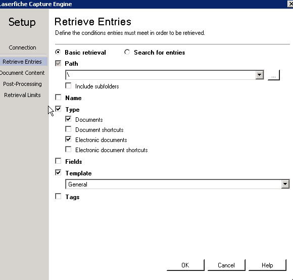

You do not need to use the retrieve and collect tokens activities when pulling in the documents, just go to the template and the field in question and use the original document token for that field. You can do this by setting in the "Retrieve Entries" menu for the scan settings that the template be pulled in, or its specific fields. Like so:

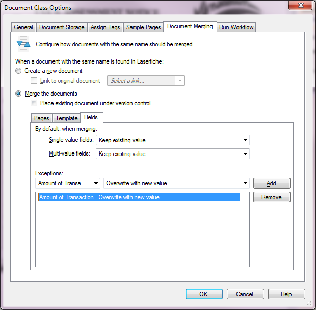

replied on July 6, 2015
Ken, after your post, I started looking around again for somewhere to get this working.  Then I found the Document Merging page and changed the setting to (see below).  This worked, after I made sure my retrieval folder and the Document Storage folder locations were the same!  So, it worked great.  Thanks!
