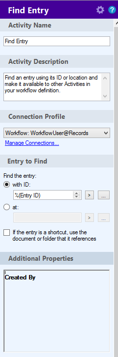

You will need to perform another find entry and then add the created by as additional metadata to retrieve like this.

I guess the issue is that I am not using a Find Entry activity to do the re-processing. We are simply dropping them into a process folder and by doing so, it will kick off the workflow for each entry in the folder. Is there no other way to retrieve the creation date?

This is the best way. I do wish you could add some items like this in the workflow properties for the starting entry sometimes, but find entry with an EntryID stated is a very quick process itself.

Blake - You could get the document creation date using an SDK script activity but to concur with John, the Find Entry activity will do the same thing...

Specifically you need to add the 'Creation Date' not the CreatedBy

Blake - It is an extra step but if you bind the Starting Entry to a 'Find Entry' activity you can get the document creation date as a token;
