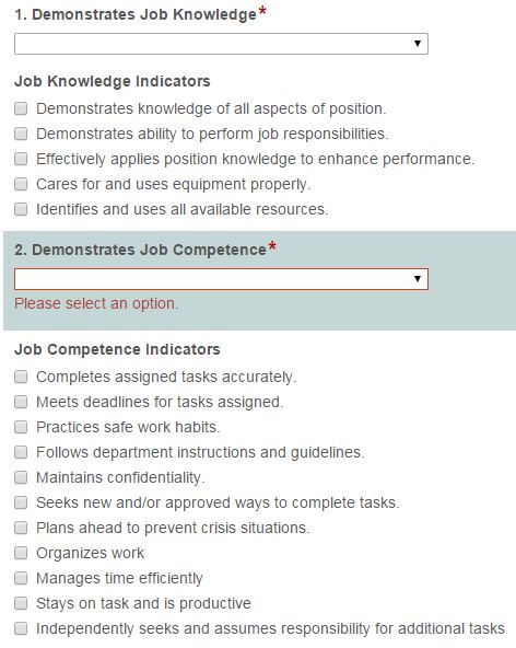

We have an evaluation form that has 4 sections. Under each section are different job competence indicators that can be selected. For each section there is a drop-down field that has the following values: Meets or Exceeds Standard, Needs Improvement, or Unsatisfactory.
We have had a request that when Meets or Exceeds Standard is selected, to mark all of the job competence checkboxes in the next field. I'm sure this is doable using jQuery, but could someone give me some guidance? Below is part of the form I am referring to.

replied on June 23, 2015
Alex, thank you for the quick response.
One more challenge for you. For some sections, there may be more than 1 field for job competence indicators. Only 1 will be displayed at a time depending on the value in another field, but is there also a way to make sure that only the job competence indicators are checked for the currently shown field?
