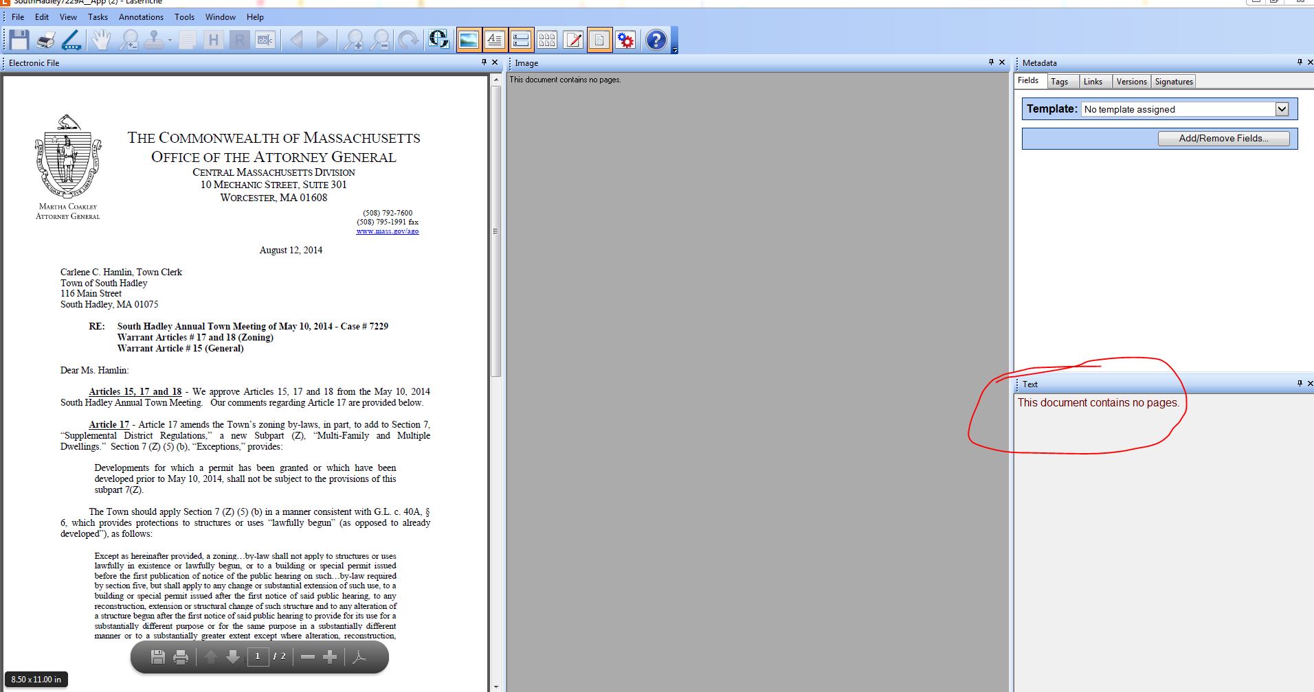

          I want to extract text from an imported pdf file. There is an option in the SDK (DocumentImporter.ExtractTextFromEdoc) which specifies that you can do that . The document gets imported with no issues but it is without any searchable text.  I have also attached a sample file that i am using for testing. The file definitely has searchable text.
What am i doing wrong ?

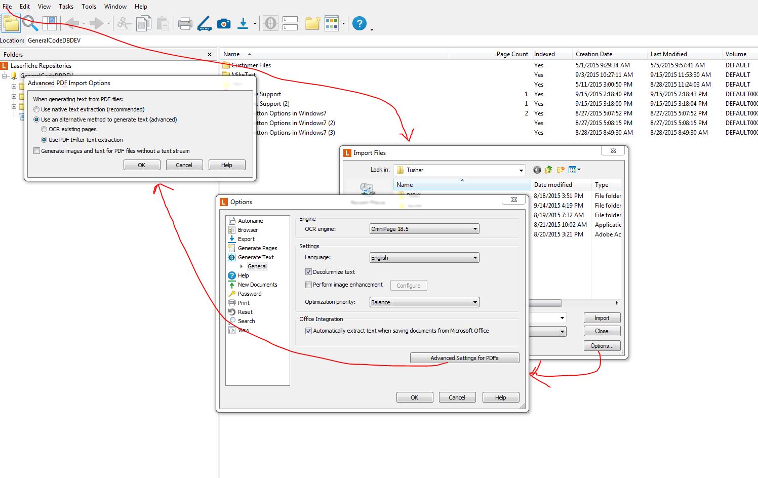

Update: I have installed the latest version of the client and i am using the latest sdk. I can do the extract text using the client , but i still cannot do the extract text using the sdk.
The text attraction works using the laserfiche client (latest) using both
1) native text extraction and 2) extraction using pdf ifilter  (See image for details)
I have pdf ifilter 9 (64 bit) with adobe reader 11 installed.
