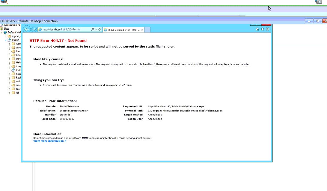

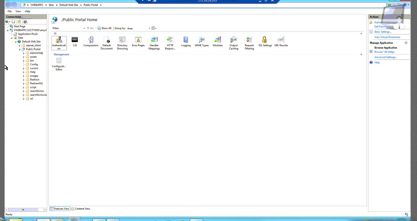

I keep getting a 404.17 error when trying to create a weblink directory. This is on a 2012R2 server. I added the application under default website. I pointed it to the web files location with all the info i just copied from the old server virtual directory path. Do I need to create an application or virtual directory? I have attached screen shots of what I have and the error. It is a MIME error. The other server was a 2003 server so the directory was setup a little different

I'm wondering if the issue is related to the web application name you're using. There may be a problem with trying to parse the URL when the browser encodes the space character with %20.
Try removing the web application in IIS, and then create a new one using a name that doesn't have a space, i.e. PublicPortal.

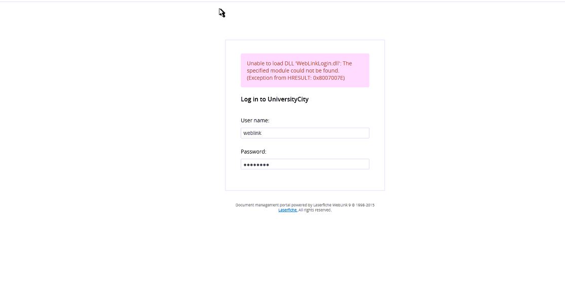

Check the Weblink App pool and change it to use .net 2.0 if it is using another version.
replied on June 22, 2015
Ok, i changed that and now it gives me this... i have it setup for anonymous and to use the weblink username for logging in.
replied on June 22, 2015 • Show version history
Please look at https://support.laserfiche.com/KB/1013646 and apply it. Basically you are missing a component

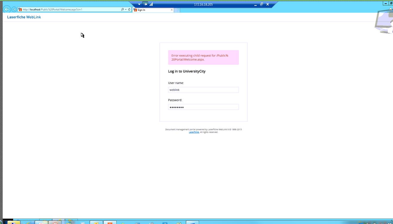

Yeah I have found that. I applied that application and now when you click browse it goes to this error. I can hit refresh and it logs in

I'm not sure what you mean by "now when you click browse it goes to this error."  Are you getting this window after logging into a shortcut?  Can you login to Weblink first and if so, do you get the same message?
It is weblink 9. If you click browse from INETMGR on the application site it goes to that error. I then refresh IE and it logs in

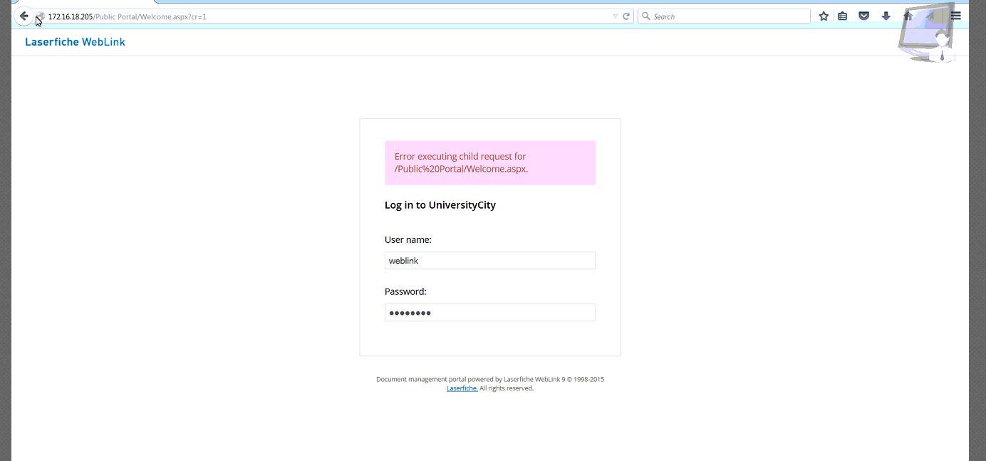

I was using IE. I just tried using Firefox and chrome with the same results.
If I hit refresh at that exact screen it will log in
