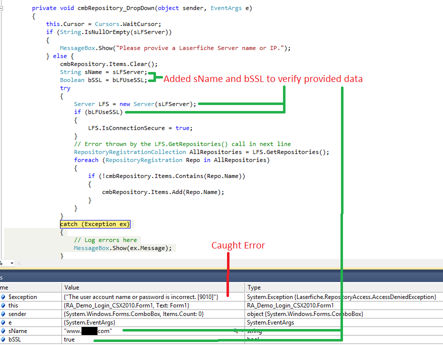

Since Robert was able to make it work and his MethodTracer sample is in C#, I figured I would try it in C# to see if it made a difference.  It did not.
Here is a screenshot of my code with the caught error:
Here is the content of the RA.Log:

From the LF 9.2.1 client on the same PC, I can attach to the server and the repository dropdown of the attach process will fill.  Robert, I can provide you my server name (in email) if you want to test against it.
