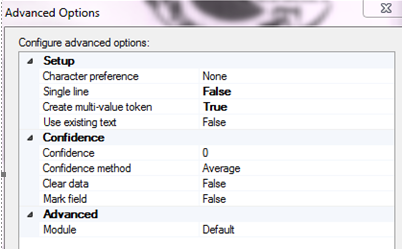

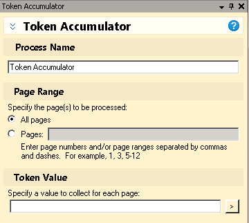

I have Zone OCR set to read all pages, single line False and create multi-value token True. Token Accumulator is set to all pages as well, collecting the Zone OCR token. I'm not getting any duplicates for single or multi-page documents. Could you confirm your Zone OCR configuration?

We have a Token Accumulator activity in Quick Fields 9:

Ok I had a look at this remotely with the customer. I confirmed: The token we're using to accumulate is the multi-value token from the Zone OCR. That Zone OCR is running on all pages of the document. Here's exactly the result we're getting:
WITHOUT using the token accumulator the Zone OCR token just keeps the last page. It looks like it overwrites the token for every page of the document so the result is:

I use the Token Accumulator in post processing and set post processing to run before storing the document. I use the Zone OCR token. The result I get for the same sample data as above is:
Token Accumulator data:
444
555
444
555
If there's a single page document (using the same sample data as above) the result is:
111
222
333
111
222
333

That looks the same.
I see the behavior you're seeing if Zone OCR is set to page 1 instead of all pages.
Could you move both Zone OCR and Token Accumulator in Page Processing and try again?
replied on June 22, 2015
Moving the Accumulators into Page Processing worked. Thank you!
