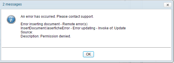

I have a LincDoc form that has an action "append uploaded file to document" and it has been working up till a few weeks ago. Our VAR was able to narrow it down to LF permissions but that is all- no resolution yet. I looked at the permissions for the folder that the form goes into and made sure that Lincdoc can save to it and it can. (This is the only form that does this)
Attached is the error that I get, it is just odd that I get the error now but didn't get it before. Any help is appreciated!!
replied on June 18, 2015
Fixed it:
I noticed that the LF configuration for that form had some issues so I deleted it and set it up fresh. The Security Config had all groups checked for everything and if you go to Repository>Folder the last field below the first pane had some values that it didn’t have to have/shouldn’t had.
It has been a number of years since I have looked at and encountered this error. I don't remember exactly where it is but in LincDoc there is a permissions;/connection into Laserfiche. Also there is a LincDoc connector that is loaded on the Laserfiche server, If I remember correctly this will also tell you if there is an active connection.
replied on June 19, 2015
Yeah that was all working correctly, and all other forms that didn't have the appending action worked just fine but it turned out to be the Repository itself went all crazy so after re-doing the connection to the Repository from the LincDoc interface it all worked! Thank you for the tip!!
