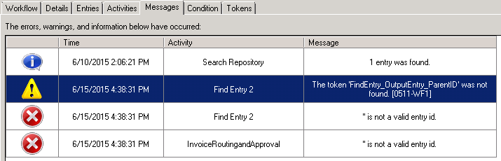

I have a find entry activity that finds the starting entry and returns the additional property Parent ID. This should create a token called FindEntry_OutputEntry_ParentID. The token shows in the token picker.
_________________________________________________________________________
When I run the workflow I get this message that the token does not exist.
When tracking and viewing tokens (organized by name) I can see that the token was never created as it should be. This only happens intermittently, how is this possible?

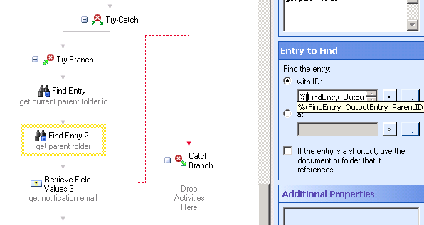

I am not sure how it could be out of scope. There are no conditions, loops, etc. This is just a linear set of two activities. I would be unable to assign the value to a token since the token I need to reference does not exist at all, see final screenshot showing all tokens.

Your screenshots only show a partial picture, so there's not enough information to troubleshoot. Carl might be right, but it's impossible to tell from the screenshots.
Something is definitely weird because your activities above the Try-catch branch and inside it have the same names and that shouldn't be allowed.
Side note, you don't need 2 activities to get the Parent Folder. Running Find Entry on the Entry Path token will accomplish the same thing.
replied on June 19, 2015
Those are two different screenshots of the same activities. I added a line between them for clarity. The try catch was added afterwards to prevent the workflow from failing due to a missing token.
