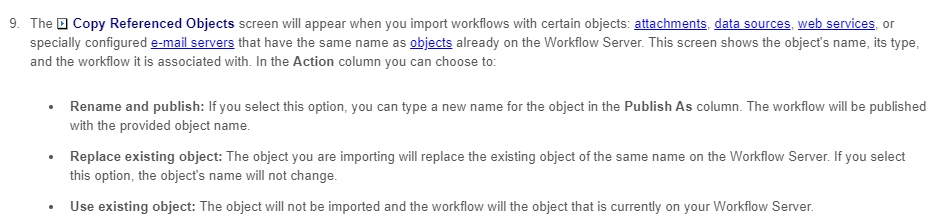

We are currently syncing our dev/qa/prod environments, and as part of that strategy, we are naming the objects the same across the 3 environments, so in the import wizard, we will choose 'Use Existing Object.'  Outside the potential to choose 'replace', would the scenario presented in this question use the Prod asset (works as 'Use Existing') asset or replace it with the Dev Object?  I notice you said there would need to be remapping, but that made me think you assume unique names across all 3 environments.  Any insight is appreciated.
replied on January 28, 2022
Selecting "Use Existing" should use the object configuration of the destination workflow server as referenced in the Workflow Administration console and NOT replace it w/ the object from dev.
Example
A workflow activity makes use of a data source named "Business Tools" which is configured to a [devserver.business tools] sql table.
Upon promotion to your QA environment via the Export/Import process - if you have an existing data source on the QA Server's Workflow Server, named "business tools" and are presented w/ the question of "Use Existing" it will use the QA Server's data source and NOT replace it with the Dev Object.
Assuming the Workflow Server in the QA environment has a datasource "Business Tools" mapped to [qaserver.business tools] - the imported workflow will use the qaserver.business tools database and NOT the dev server sql.
Added confirmation Via - Importing Workflow Import Files (laserfiche.com)
