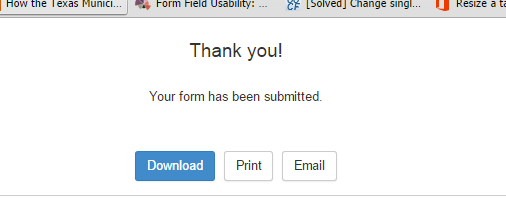

How do you hide the print button that is available when submitting forms?

By default there isn't a print button. It may have added. If it is after the forms is submitted and showing on the Thank You Message page, try the following:

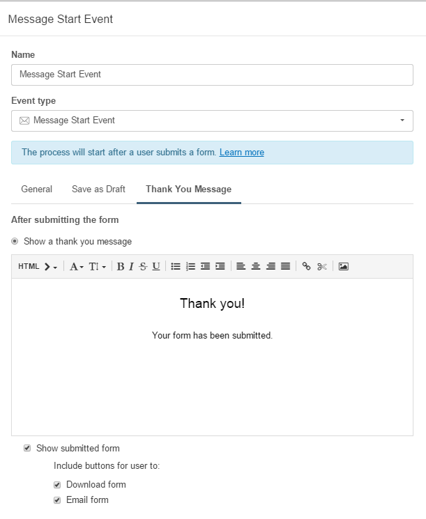

Go to the Process Modeler for the process in question. Double click the Start icon that is on the canvas. Select the "Thank You Message" tab. See if there is a print button there.
replied on June 12, 2015 • Show version history
Thanks Blake,
I had found the options to turn off the download and email options but there isn't one to add print or remove it.
I'm using Version 9.2.0.908
Try unchecking the "Show submitted form" option and see if that removes it.
Thanks- That removes all three buttons but I do want the option to download the form which I cannot check without the Show submitted form enabled.
