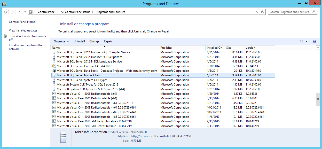

Ensure SQL Native Client 2005 is installed on the machine, there are cases where missing this version of SQL Native Client , prevent the utility from working properly, we have experience the issue in our office where we had SQL Native Client 2008 present but not 2005 , issue got resolved by installing SQL Native Client  2005.  From programs and Features, review the SQL Native Client version, in our system show 9.00.5000.00
In case the issue does not get address, kindly submit a case with support and attach to the case the Log file that gets generated by the tool.
