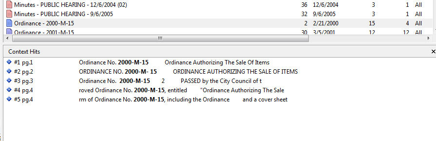

Thanks, Ashley.  However, I am actually trying to find out how to get it to display similarly to the attached image.  The screenshot is how the search results are displayed in the Client, is this possible on WebLink?  Thanks for help.

Unfortunately, having a separate pane for context hits cannot be displayed easily in WebLink 9. This is noted as a feature request!
