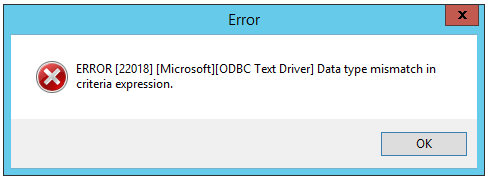

When I Query Data within a Workflow, if I only use numbers, it returns rows. However, if the search includes letters, I get a "Data Type Mismatch in Criteria Expression" error. Has anyone run into this or have a solution? It's a CSV file, not a SQL database so I do not have specific data type declared.

replied on June 3, 2015
For the benefit of other readers, the ODBC data type for the field was an integer field.  Setting it to LongChar resolved the issue.
