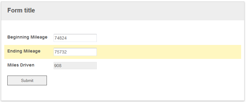

Hi Penny,
In your form, did you make the "Miles Driven" field read-only? If so then that could be the cause of your issue. If that is the case, then what you would need to do is to use Javascript to make that field read-only. Here's a generic example that works for me.
Form:
Javascript:
$('.dMiles input').attr('readonly','True');
$('.bMiles input').on("change", function () {
$('.dMiles input').val($('.eMiles input').val()-$('.bMiles input').val());
$('.eMiles input').on("change", function () {
The beginning mileage field uses the CSS class, bMiles. The ending mileage field uses the CSS class, eMiles. The miles driven field uses the CSS class, dMiles.

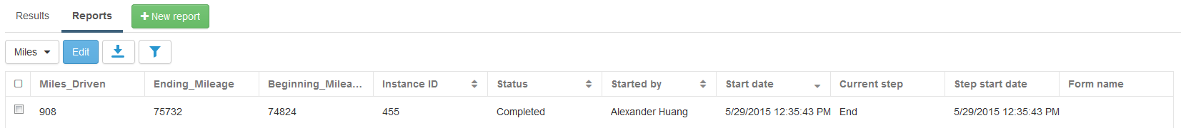

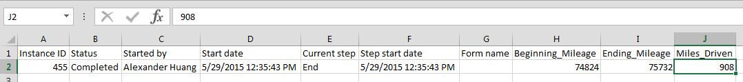

Report:
If you're still having an issue, can you let us know what version of Forms you're using and also what Javascript you're using?
