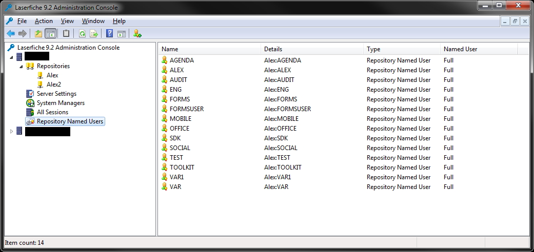

replied on May 26, 2015 • Show version history
All I can see is from this print screen below. It never tells me what they are associated with. If there is another place to look please let me know.
You should have a separate node named "Repository Named Users" that you can use to see which users from which repositories on that server have been assigned a named user license.
I found it after I collapsed everything and did a refresh! Thank you!
