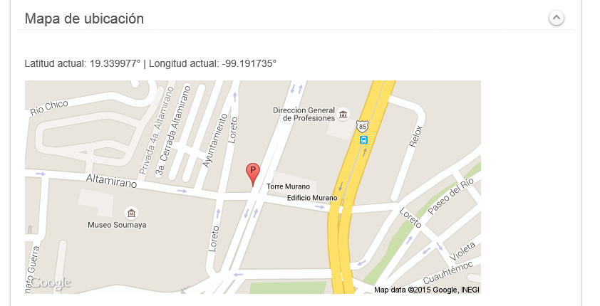

Hola:
Estoy trabajando con FORMS 9.1.1.1517 y utilizando un campo HTML Personliazado muestro una imagen de un mapa obtenida a partir de una función de Geolocalización. El formulario pasa por medio de un BP a otro usuario y la imagen se muestra sin problema, Pero al llevarla al repositorio en un archivo tif la imagen del mapa no se muestra. Agradezco su apoyo y atención a este problema.
function showMap(LatLng) {
	var position = LatLng.split('|');
	var latitude = position[0];
	var longitude = position[1];
	var output = document.getElementById('map-canvas');
	output.innerHTML = '<p>Latitud actual: ' + latitude + '° | Longitud actual: ' + longitude + '°</p>';
	var img = new Image();
	img.src = "http://maps.googleapis.com/maps/api/staticmap?center=" + latitude + "," + longitude +
		"&zoom=17&size=700x300&markers=color:red|label:P|" + latitude + ',' + longitude;
	output.appendChild(img);

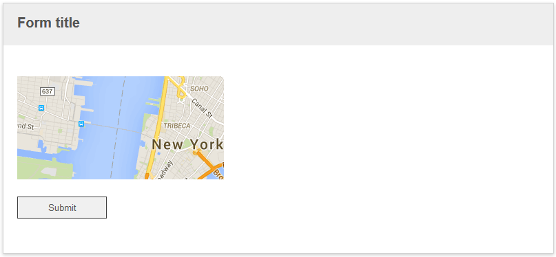

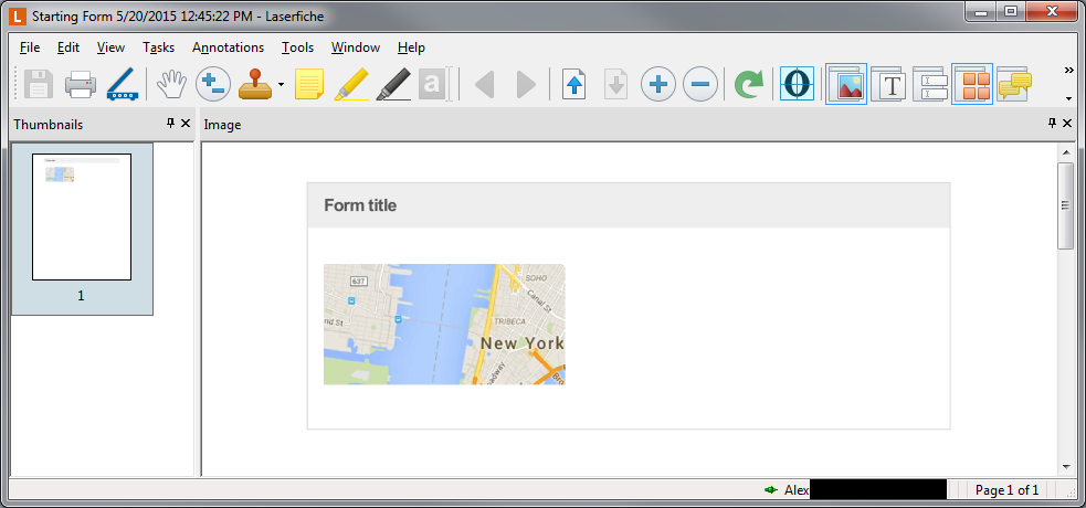

I haven't tried this in Forms 9.1.1, but I was able to get things working in Forms 9.2.1. I created a form that only has a custom HTML field with the following
<canvas id="map-canvas"></canvas>
I then added the following Javascript
  var google_tile = "https://maps.googleapis.com/maps/api/staticmap?center=Brooklyn+Bridge,New+York,NY&zoom=13&size=600x300&maptype=roadmap";
  var canvas = document.getElementById("map-canvas");
  var context = canvas.getContext("2d");
  img.src = google_tile;
  img.onload = function(){
    context.drawImage(img, 0, 0);
Here is what the form looks like
And here is what the document looks like in my repository after I submit the form

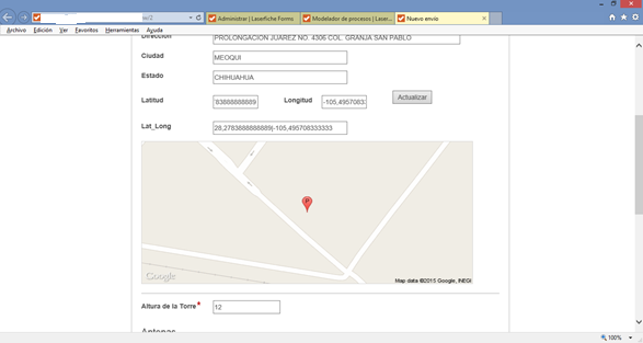

replied on May 21, 2015
Hi,
I followed his instructions and the result was as follows:
The map is displayed but no location.
Any suggestions?

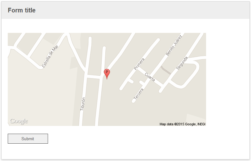

replied on May 21, 2015 • Show version history

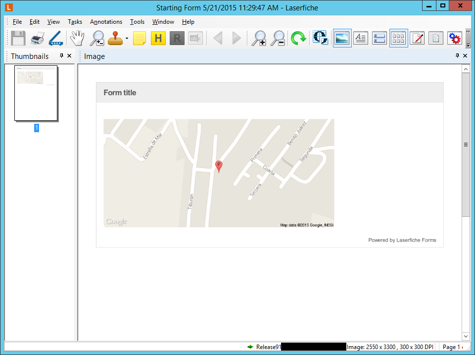

Gerardo,
Can you test in a new form with only a single custom HTML field using
<canvas id="map-canvas" width="700" height="300"></canvas>
and this exact Javascript
  var latitude = "32.50923333";
  var longitude = "-117.0975806";
  var google_tile = "http://maps.googleapis.com/maps/api/staticmap?center=" + latitude + "," + longitude + "&zoom=17&size=700x300&markers=color:red|label:P|" + latitude + "," + longitude;
Here is what my form looks like
And here is what the document in the repository looks like
Note that this was using Forms 9.1.1 and Laserfiche 9.1.1

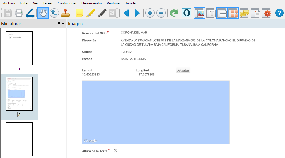

when the values of latitude and longitude is static, forms sent the image to LF.
when I apply the values using fields latitude and longitude in the format requested, does not sent the image to LF
i need use two fields in the format with latitude and longitude

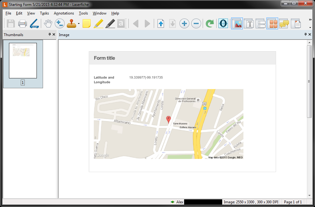

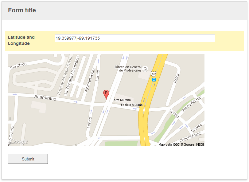

Here is an example that works for me:
Form
The input field is Field1 and uses the CSS class latlong. Then I have a custom HTML field for the canvas underneath it.
Here is the Javascript
  $('.latlong input').on('change', function() {
    drawMap($(this).val());
  if ($('#Field1').prop('tagName') != 'INPUT') {
    var divlatlong = document.getElementById("Field1").innerHTML;
    drawMap(divlatlong);
  function drawMap(n) {
    var position =  n.split('|');
So when the form is being filled out, you can type in the latitude and longitude and it will update the map on the form. Then after the form is submitted, the input where you get the latitude and longitude from is converted to a div so now you need to get the value from the div so that the map is properly drawn onto the submitted form.
Here's the document in the repository

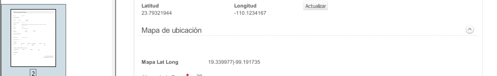

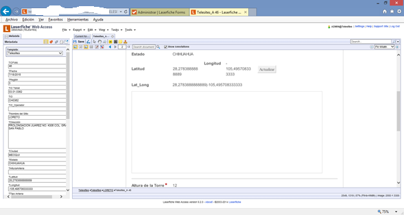

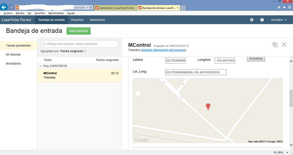

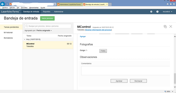

replied on July 16, 2015 • Show version history
Hi Alexander
Not work.
The process is:
Setp one: the user one start business process with the form
The image map is ok.
Setp two: the user two approval the form and send to repository.
The image map is ok, then send to repository with 'aprobar' button.
So ... in repository we can not see the image map.
Only seen the box
The code  (JavaScript) in the HTML custom field:

It is all the code.
Can you help us?
