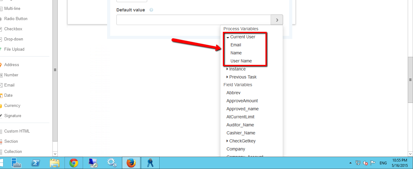

There is a requirement that a starting form which's sent from employee of a department would be send to approve by the manager of that department.
So I need to know the information from AD such as department of initiator for routing the form to the right manager
This is what I found from edit form page.
And I found this optional properties in LF Workflow.
How could I get the AD's other information from LF Forms?
Or I have to fetch out others values of AD 's information from LF workflow and fecth in the values into LF Forms.
What is the right way to accomplish this?
Any suggestion would be greatly appreciated.

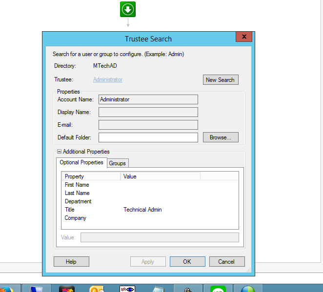

Forms should be automatically retrieving information such as email addresses from AD. It appears that your Administrator trustee does not have any information assigned to it on the AD level, so make sure the details exist in AD before you proceed.
If you are using Laserfiche named users, you can specify their email address as a user attribute in the Admin Console. Users can also change their user information on the Account page.
replied on May 18, 2015
Hi Cathy,
      you could see from my screenshot of Edit page that I can retrive some AD information as
1. user name
2. name
2. email
from LF Forms because there are variables for reference.
But the other AD information such as
1. First Name
2. Last Name
3. Title
4. Department
5. Company
There are no such variables on the Edit page or the Account page.
But I can find the other variables from LF Workflow on optional properties tab.
If I need to use the Department or the Title value from the AD information to be display or reference on LF Forms.
How could I do that?
Or do I have to fetch out information from LF Workflow and then fetch in LF Forms?
Please suggest the right way to get these information.
Regards,
