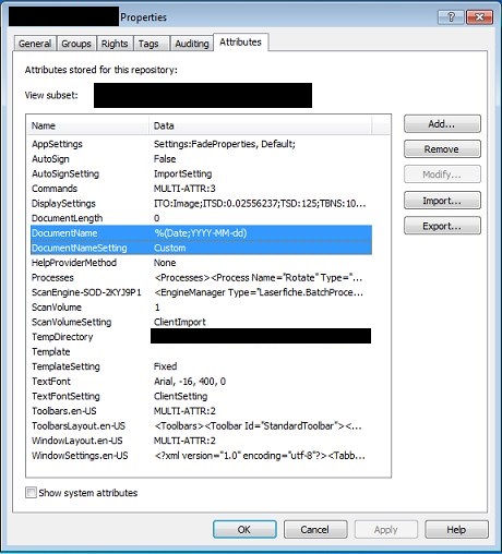

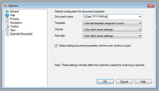

Well your scanner would not need to do this every time.  You can set this as the default within the scanning interface by going to File>Options>Scanned Documents and changing the Document Name settings from <use client import settings> to Custom.
You can even push these settings through the LF Admin Console User Scanning Attributes:
replied on May 15, 2015 • Show version history
I believe this link will help you understand how customizing/formatting a date field works, although your custom date is different.
Essentially, you'd want to format the date token when scanning as the following:
%(Date;YYYY-MM-dd)
