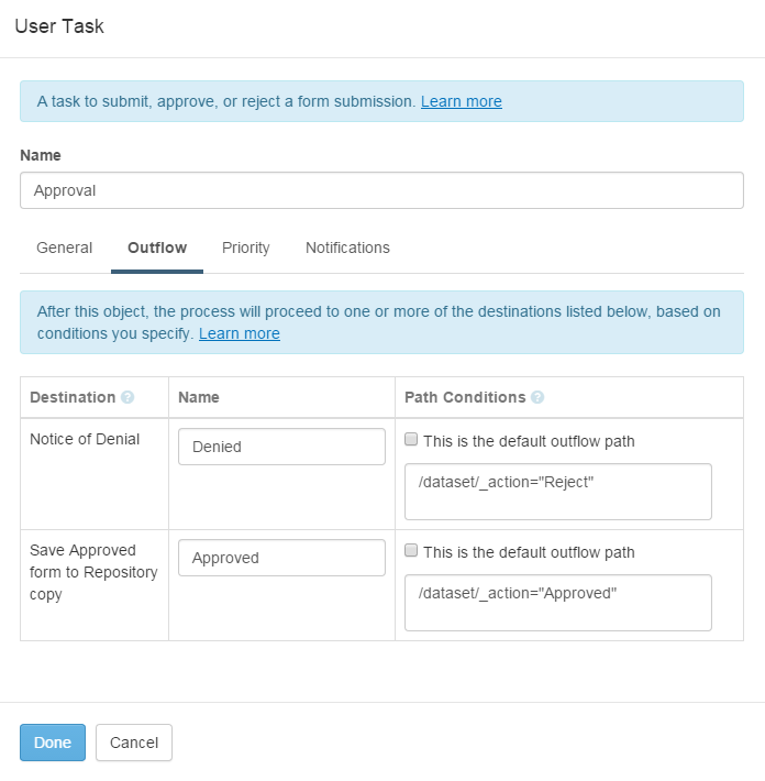

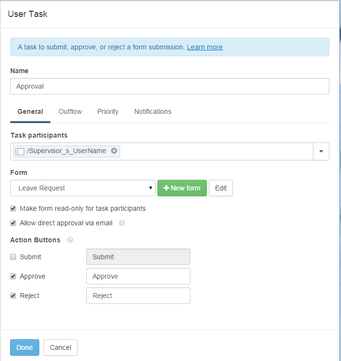

Your dataset/_action="Approved" (on your approval outflow) should actually equal "Approve" as that is what the action button is titled.

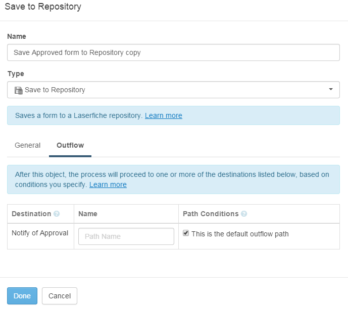

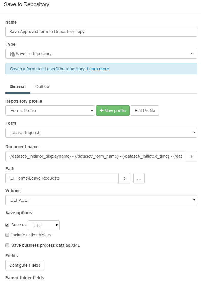

Can you attach screenshots of the properties of your Approval and Save to Repository tasks, specifically the Outflow configuration?
replied on May 13, 2015
Approval Page:
Save to Repository Page:
Darrell,
   Thank you very much, that was indeed the issue. It's often these little things that end up making me feel like an idiot.
