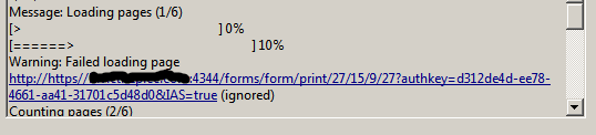

Warning: Failed loading page http://mydomain.com/forms/form/print/25/15/9/25?authkey=edd03215-fc44-4b63-8ffc-d2d49888b274&IAS=true (ignored)
I found if I enter information into the Primary Forms Server URL it changes the site that the forms product attempts to access however the system is obsessed with using http instead of https. Even when I define https, the system tries the impossible syntax of http://https://.
Ok, figured it out. You have to enter the server name and port into the text field and check the use SSL checkbox. The description was super confusing, said only needed if you have multiple forms servers.

In the FormsConfig site, under the "Forms Server" section, can you confirm that the primary Forms server URL is valid and that you have "Use SSL connection" checked?
replied on May 12, 2015
That is what it was, that section was not filled out because we only have one forms server and then I was trying to enter the entire URL into it.
