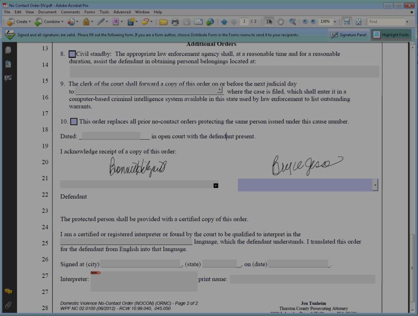

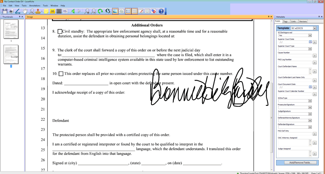

Unfortunately, the problem is that the signature is getting blown up to be very large compared to the digital signature block that contains the signature.

I have attached a screenshot of view of the PDF and of the Tiff after conversion.
replied on May 19, 2015
I just wanted to give everyone an update.... it is the size of the box and the font that is used.  I shrunk all the boxes to half the size width and height and then verified it is set to Time Roman.  Works like a charm.
