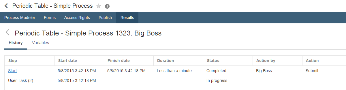

If you go to your Forms > Forms Business Process > Results > Issue instance, at which task is it stuck in progress?
It should look something like this

replied on May 8, 2015
Hi Andrew,
   Thanks for your reply. It's the service task set to save the form to the repository that's stuck in progress. It shows the status for that as Suspended. If I click on the Retry arrow, it tries, but then switches back to Suspended.
