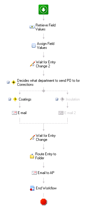

Any ideas why workflow is sending two emails for decision #1? When I change the field values to the needed selection for this rule, it will send the email and pause the workflow as it should, but after I edit the document again, and change the final field value for it to to kick in Decision #2, I will get an email based on #1, as well as #2. I only want it to send 1 email per decision.

Here is an export of the WF. I have some pretty serious stuff I do in LF, and this has been the easiest process to think of but hardest to build to date.

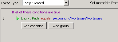

I see what you're trying to do. The easiest way to accomplish it is to use a tag or a field to indicate that the doc has already started through an instance of this workflow. Your starting rule would check that the tag is not assigned. Then as the first step in the workflow, you'd assign the tag. Any other field changes wouldn't trigger the start rules since the tag condition would no longer be satisfied.

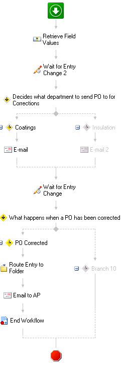

replied on May 7, 2015
this is the fix to the issue -
and the starting rule -

Was the starting rule previously set to "Entry Changed" rather than "Entry Created"? If it had been "Entry Changed" then that correlates to what John had suspected in that since the document path doesn't appear to be changing, and users are just modifying a field value, in addition to moving to the next step, it is then triggering a new instance of the workflow to run on that same document.
Moving forward though, it's best to review the starting rule conditions and make sure that there isn't a way to accidentally trigger it when it's not meant to be triggered.
