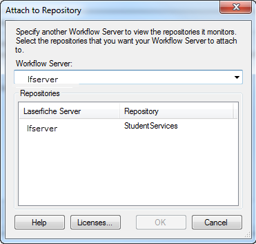

I think the answer may in the Workflow Console - the repository I'm importing to is not listed under:
       Server Configuration/Repositories
But when I try to attach the new repository to the Production server all it brings up is a window showing the repository I'm already attached to, with no way to  change it.

Ah, has the brand new repository been configured to have workflow listen to it yet?
Using workflow administration console is it listed under the Server Configuration -> Repositories node?
It sounds like a workflow subscriber isn't listening to your brand new repository. (Which is what Miruna is getting at)
replied on May 6, 2015 • Show version history
 I have now got that configured, where I could not previously. The problem was like Miruna said, my windows account couldn't add it but another account (the laserfiche workflow user) could.  (I don't understand why -- since I have all the same Laserfiche rights as the workflow account. )
