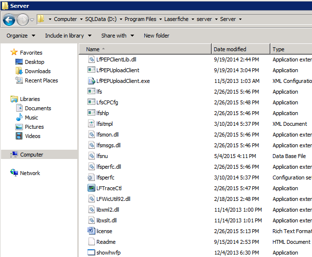

Let me step back a moment, When you get this message you are trying to generate the license for the Workflow server correct? Now that I think about it I have seen this before. Run the Show Hardware Fingerprint application. You can find  this where your Laserfiche server is installed. Copy the application (Showhwfp) over to the server that you are trying to generate the license for. Below is a screen shot of it. Run it on the workflow server. Take the information and from there you can generate a license with license manager by manually inputting the information. Once it generates the license file, you can copy the license file over to the workflow server. I don't have screen shots of manually entering the information as I am on Avante. I have worked with several RIO installations before and every now and then had this issue occur.
In my example, it shows D drive, that is just where my Laserfiche happens to be installed. Yours my be on the C drive.
