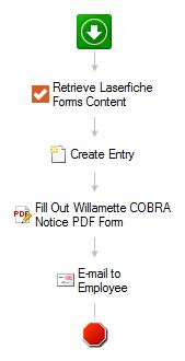

We have a workflow that is being kicked off from a forms submission. The workflow retrieves the Laserfiche Forms Content-> Fills out a Fillable PDF, and then has an email activity that currently is setup to attach the starting entry. When I tested it, it failed because it says "No entry was specified". I'm pretty sure it's regarding the starting entry. Do I need to create an entry before filling out the PDF so it will attach to the PDF correctly? Here is what I currently have:

Yes. The PDF activity has the same entry set as Attach E-doc, right?
replied on May 4, 2015
As Miruna said, you have no starting entry unless in your Create Entry process, you click the checkbox that says "Change starting entry to be output entry" under creation options. Your other option is just to target the output of the create entry in your email attachment.

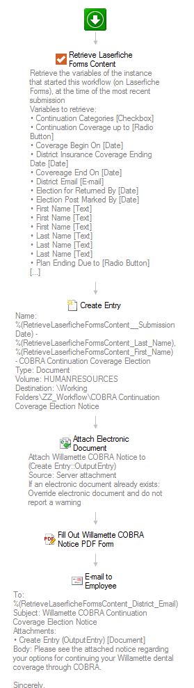

So I do need the Create Entry activity correct? And then for the Fill Out... activity I just make sure that is set to the one created for the "Create Entry" output entry? Then I do the same thing with the E-mail activity, have it set for the "Create Entry" activity output entry?
You need Create Entry, yes. Then you need Attach Electronic Document to set the PDF on the new entry. Then you need Fill PDF to fill in the fields. Then you can email it out/
OK, so this is what I have come up with based on your feedback. Does that look correct?
Yes
