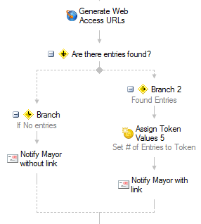

If it helps any, here's one way to accomplish what you may be looking for if you can perform the logic before submission of email.
Could also perform 1 email activity after exiting the conditional statement and just use the branches to set variables to be included in the standard email.
