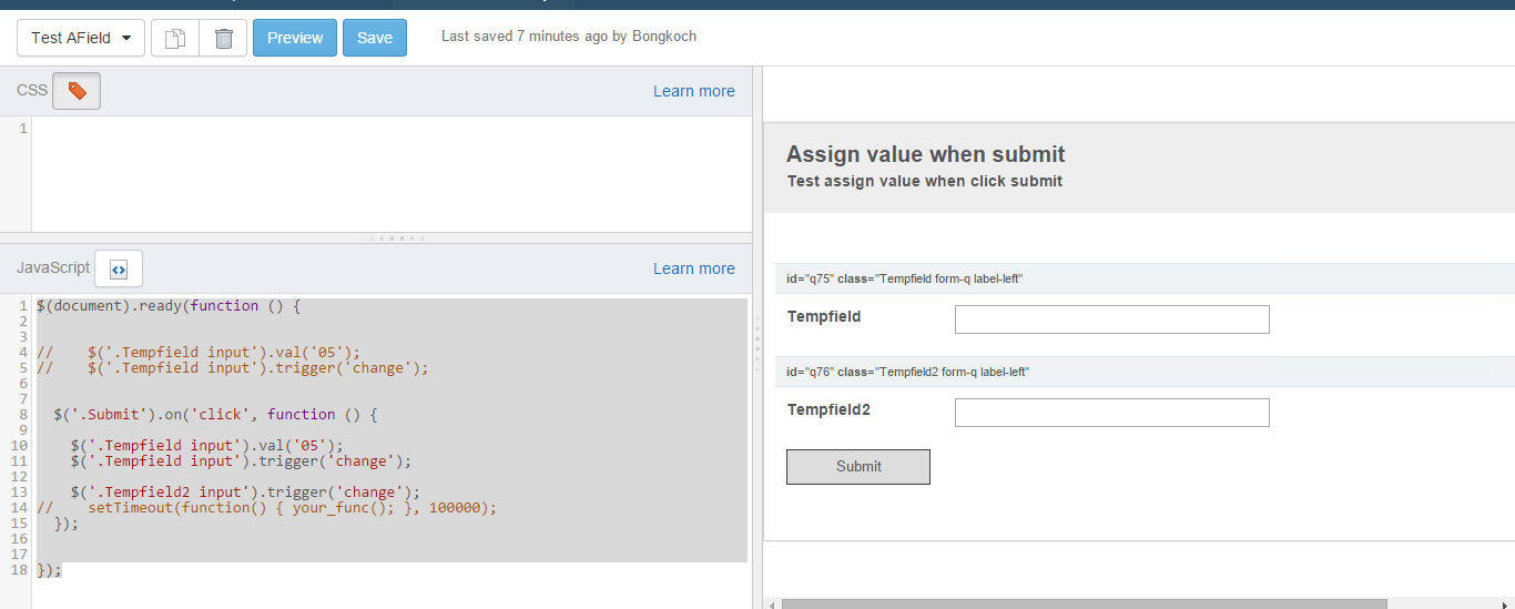

   I have 2 forms , a started form for submitting and a save to repository form to display that form field.
Here is the coding of started form
and here is a output form in repository.
And the lookup rules page
The scenario is when user click submit button then' Tempfield' field which's assigned a value will trigger stored procedure and fill in another field 'Tempfield2' and this field 'll be passed through output form then save into repository.

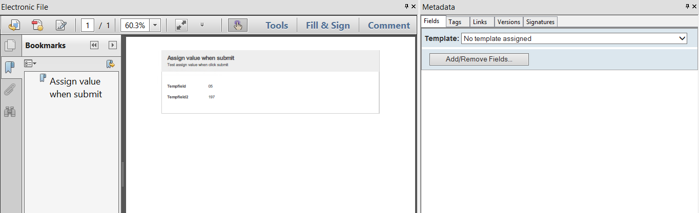

I could see values of both fields for a second when clicked submit button but I found that Tempfield2's  value disappear on output form in repository.

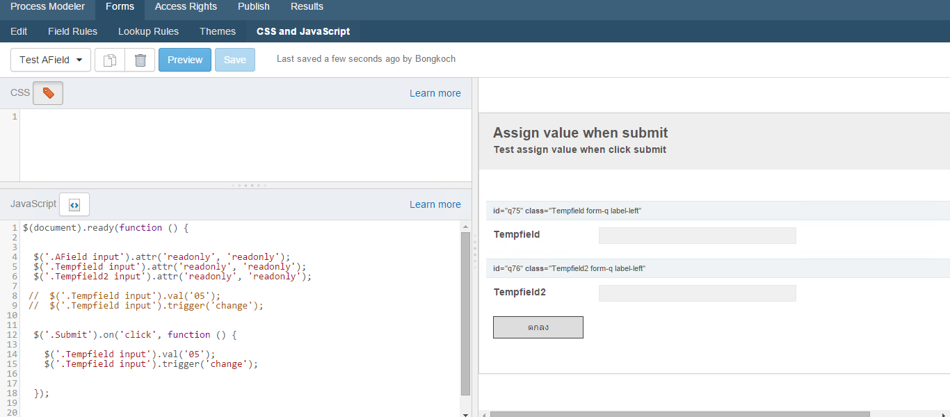

Here is my started form javaScript page
And here is my output form JavaScript page
you can see no field set the properties as read only at all.

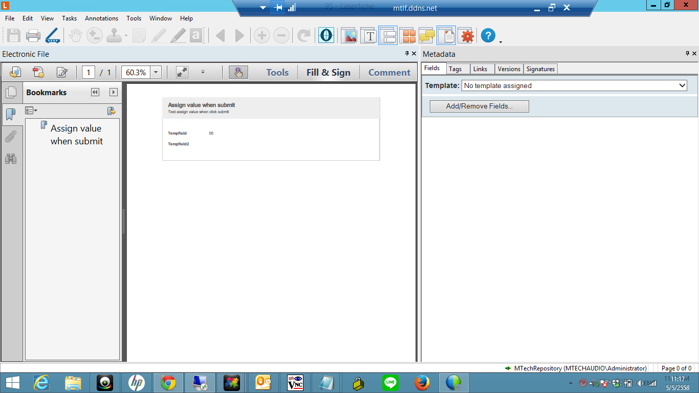

Here is output screen from the repository.
And the last one is the results page of the issue process.
You can see no value assign to Tempfield2

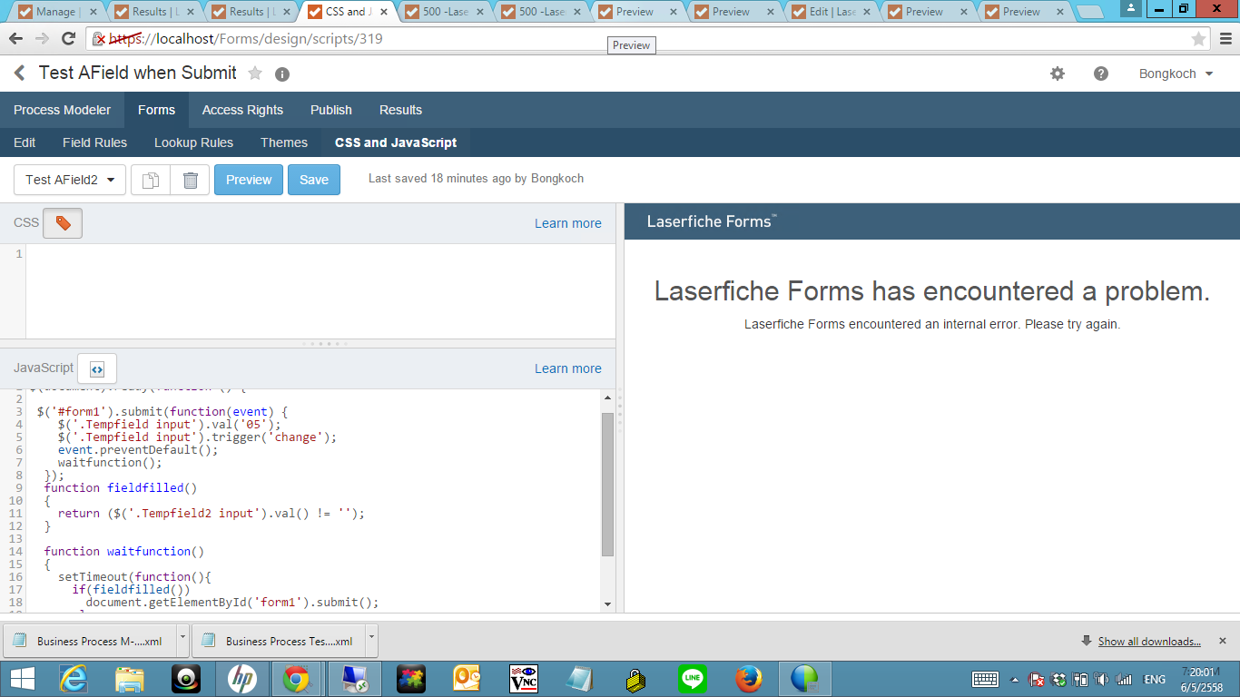

I 've tried your coding and replace your fields with mine. I can see value of  both Tempfield and Tempfield2 're appeared for a second. Suddenly a error message showed up.
Here is the error message screenshot .
Abby, please suggest.
Regards.
