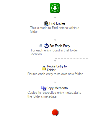

Here is a screenshot of a simple workflow that may help with what you wish to achieve,
Hope this helps.

That looks amazing!  Thanks!
