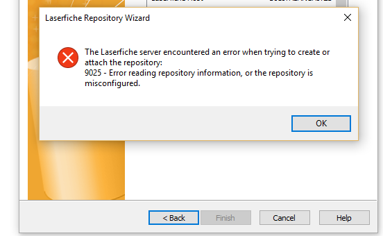

replied on August 18, 2016
I'm also getting the same error when trying to register a new repository. I am the admin on the machine so I don't think its a rights issue, but I could be wrong. Is this something to do with the database???
Error 9025.PNG (32.14 KB)

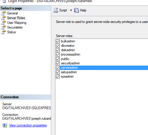

Hi Steven,
Thanks for the prompt response. I gave it sysadmin rights, but still getting the same error. Below is the screenshot:
Error 9025_2.PNG (17.95 KB)

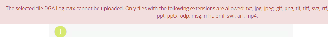

Yes, I'm authenticating via Windows, and the LF Server is on the same machine as the SQL Sever. It's refusing to attach the evtx log file, saying that only certain file extensions are accepted
Here's the screenshot

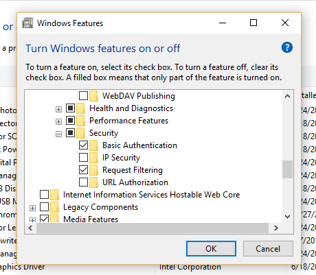

replied on August 19, 2016 Show version history
I've realized that my IIS doesnt have Windows Authentication. Does anyone know how I can enable it. In my setting it just has "Basic Authentication".
Do I need to upgrade to Win 10 Professional to get Windows Authentication?
