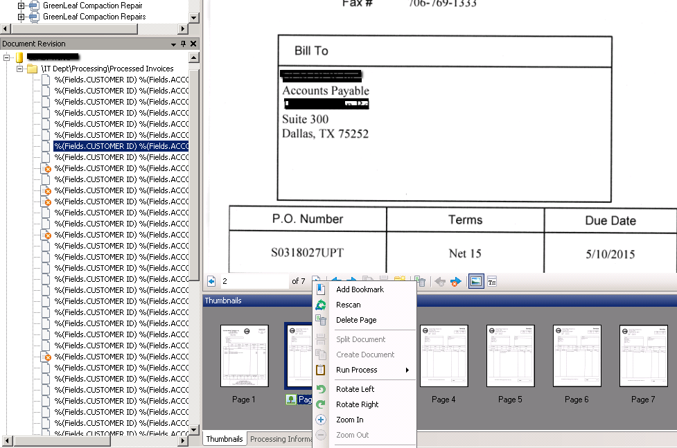

2. Every so often when a document doesn't classify and it is a 2 page document, I will split the documents i Quick Fields. Sometimes the "split" option is greyed out and it won't let me split. I then have to import into Laserfiche, split the document and then reprocess with Quick Fields. Any insight into this will be helpful.

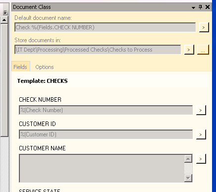

Here is the Document Class.

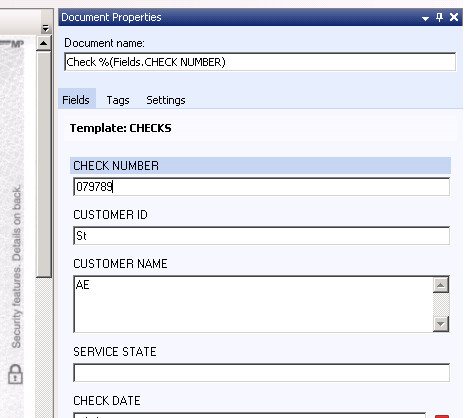

Here is what I get on the document.

Thanks for posting those. Let me make sure I understand what's happening:
For the example in this screenshot, Check Number and Customer ID fields are both incorrect? But the correct text is captured for those fields (using Zone OCR) when this document is used as a sample?
And for Customer Name, you didn't specify anything for that field in the configuration, but the "AE" shows up there somehow?
replied on May 18, 2015
That is correct. Customer ID should be "AE" and Customer Name should be blank.

Here is a screen shot. As you can see I selected the second page. There isn't a particular document that this happens with, it is random. I have tried sending back to Laserfiche and rescanning, but the same thing happens again. The only way I can resolve is to split it in Laserfiche and then reprocess through Quick Fields.
replied on May 1, 2015
1. Can you post a screenshot of the session configuration? (make sure not to show any sensitive information)
2. Does this happen with any particular type of documents? Have you selected a page that isn't the first page before you try to click the 'split' option?

2. The ability to not split the document is after I have assigned it to a document class. Sometimes it has been classed and I just need to split the document.
1. Is this happening only for multi-page documents? If the Zone OCR runs on all pages (as occurs in first page identification), your correct Zone OCR values are likely getting overwritten by text in the same location on subsequent pages.
2. To be able to split the document when it is Unidentified, right click on it in the Document Revision pane, select 'Assign Document', and choose the correct Document Class. Once it is assigned to a class, you should be able to split the document. Then, if necessary, you can use 'Assign Document' again if the new document should be a different Document Class.
