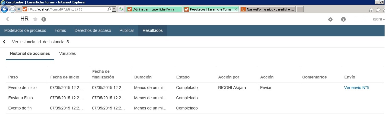

- You can also browse to the issue Forms Business process and go into the "Results" Tab and click the "Start" as shown here
Basically, whatever you see there, is what is supposed to be saved into the repository.

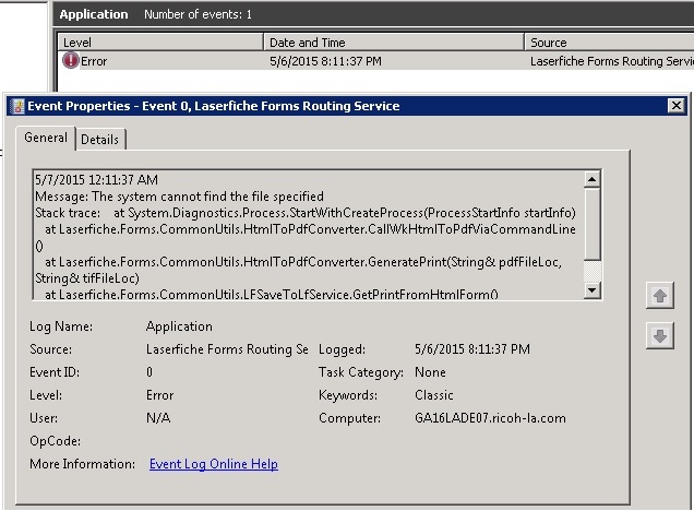

replied on May 7, 2015
Hi Andrew,
Change the process and now send to workflow, in results forms says complete, but in the event viewer has error.
That error is the same that show when sent to a repository.
I don't know why this happen .
Attached images.
Event Viewer.jpg (90.99 KB)
