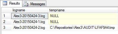

1. Query the auditlogs table in the repository database and there should be a row for each rolled over audit log (both ones that had succeeded and ones that had failed). For the audit logs that had failed to rollover, you can tell because there will be something in the tempname column. If it had succeeded, then the tempname would be NULL. Here is a screenshot showing three rolled over audit logs, one of which that had failed.
Now, what you will need to do is copy the .tmp file into the audit log rollover folder, where the rest of the rolled over log files are. Then you will need to rename the file back to its actual log name. In my case, I would rename LFAF9A4.tmp to Alex3-20150424-2.log after I had copied the file over.
Next, you need to update the auditlogs table and change the log_state for that failed rollover file from 0 to 1. I would run something like
