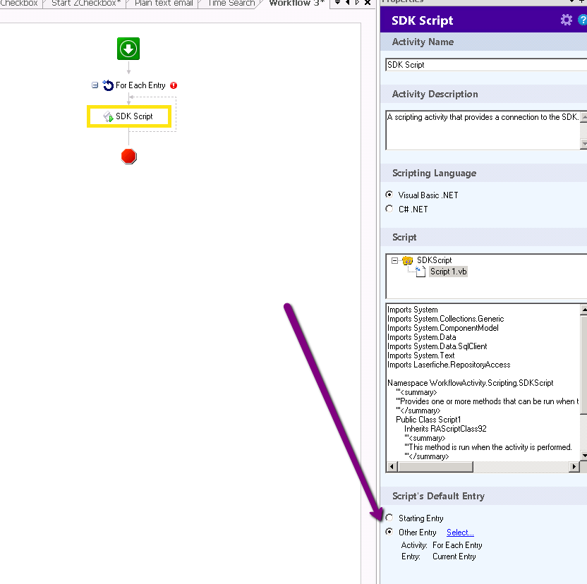

replied on April 22, 2015
I take it you're running this script inside a For Each Entry loop? Why not bind the current entry to the script so it is the one in me.Entry?
replied on April 23, 2015
Ah, didn't notice that option! That's perfect, thanks!
