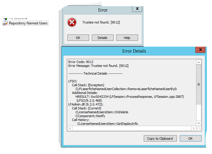

Deleted User still shows as Named Full User. Error 9012
asked on April 17, 2015
We have deleted a named Full user in Administrator Console under the Users and Groups  and it disappeared
But the user still available as Full Named user in Administrator Console under the field Repository Named User and it is not allowing us to delete and giving the following error 9012. We have checked the database trustee table and found no user in it. how to remove it.
