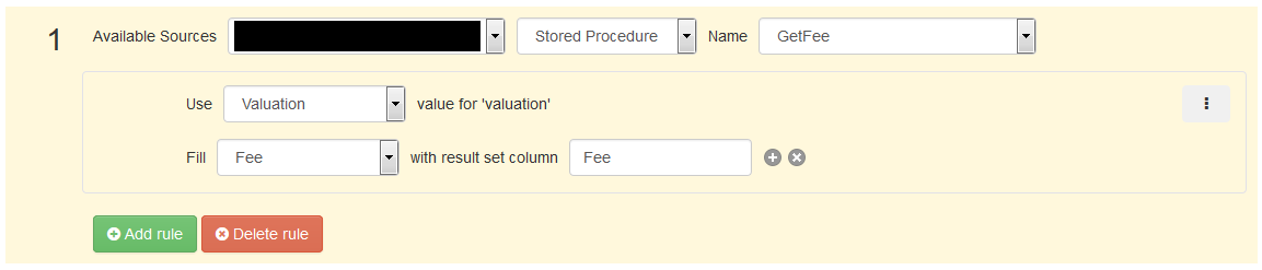

Using a form that has two currency fields (one for the valuation and one for the fee), you can then use a lookup rule like

Thanks, Alex and Kenneth for your replies.  Using Alex's example, I have this working.
Thanks again!
